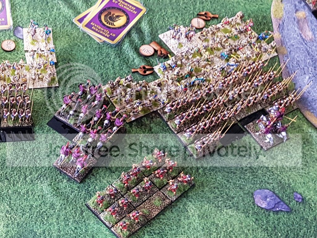

I noticed there is a similar topic but I wanted to use the specific situation to help to address the issue. During one of the games at CanCon the following occurred.

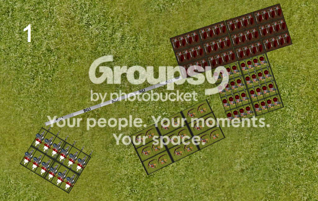

Companions charged exposed edge of the unit already engaged with the Phalagites to the front. However, not all files were directly in the fight. What is more, Companions were not in the flank of the enemy uni (see picture 1).

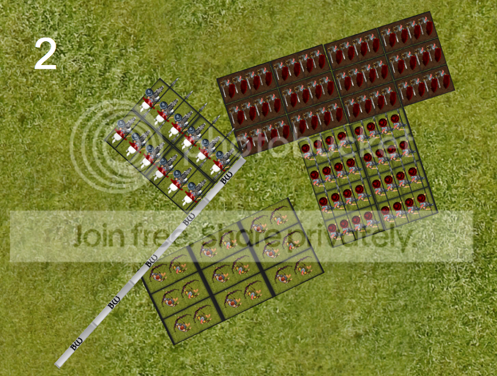

Companions made contact with one file (picture 2)

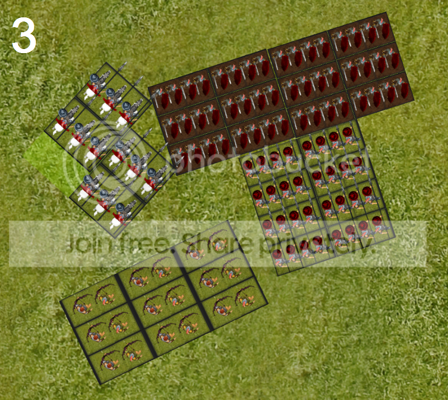

and the second file was pushed forward as per the rules on page 78, F.Moving Chargers, p.3 (picture 3).
The exact positioning of all units in area is visible on the photograph attached.

1. I assumed that 2 files of Companions Cavalry and 2 bases of Foot Warriors would fight in Charge Phase. Is that correct?
2. Since Companions did not start in the flank, no claims for flank/rare charge apply. However, do 2 bases that are in the contact to their flank edge apply their normal claims, even if they are not fighting any files to their front?
3. If a card is played for Companions in the movement phase and they would contact with full front edge to the side edges of Foot Warriors, would they claim the flank attack bonus?
Thank you in advance!
Quote from: Pawel_Mieczowski on February 02, 2019, 06:19:54 AM
Here are a few questions about this situation:
Yes
Quote
Yes - they fight as if the contact was frontal.
Quote
They are treated as if they are fighting to the front and so you cannot make a move to flank contact and get the flanking bonus.

a) Both files fight as they have contacted an enemy file.  Think of the front one hitting a file of the front two bases and the rear one a file of the rear base.  Helps.
b) They came from the front and therefore must fight the enemy frontally.  Factors are considered frontal.  In part this is about thinking about the abstraction of bases and moves.  I reality a TuG is exactly that is says - a tactical unit grouping.  So its really several units.  In reality rear and side ones would wheel to cope with an attack from that direction as the cavalary close.  So the flank conditions set the boundary whereupon I consider that to be too difficult to achieve as a natural response.
c) Bases may only contribute to a fight in a phase once.  So depending what the infantry are it might vary a bit.  Simplest situation is the front Cv fight 2 deep inf and the second 1 deep.  If they were pikes say the infantry commander would have the option to use the 3rd as rear ranks for the front two, but then it can't roll a dice itself to fight the second cavalry.
d) Aligning is always optional - but encouraged where it makes no difference.  After charge phase everything fights as if it is algined for purposes of working out who is in and who is a Supporting File.  This may need a clarry - I'll need to check - as I may have implied charge combat as well.  I'll fix in new version.
e) It can be a bit messy, but trust me its much better than the mess created by forcing andalign.  Alas that sets up all sorts of gemy traps for opening up flanks.  Imagine you make contact at a fine angle - aligning could move you a massive swing and create flank charges against you that are quite unrealistic given your real direction of travel.  This is why it is optional - but recommended when it doesn't create issues.
f) in terms of aligning cavalry go first if acrive. Align is up to 1BW , so as they hit on the flank they can't.  Had the front one hit the front corner then they could.  The SuG can be displaced to allow this.  Makes it tidy.  [so in that situation I may well have deliberately done that to make it neater].  If cavalry choose not to, Infantry can do so if possible.  But they cannot align due to the other fight.
So in short, this one plays out with cavalry in melee being a frontal with a supporting file.  Complex one I will do a video on called "Frontal charges hitting side edges".  Essentially if you didn't get a flank bonus in the charge, you won't in the melee. The only exception are the two examples for creating a melee when in corner or side edge contact already.
